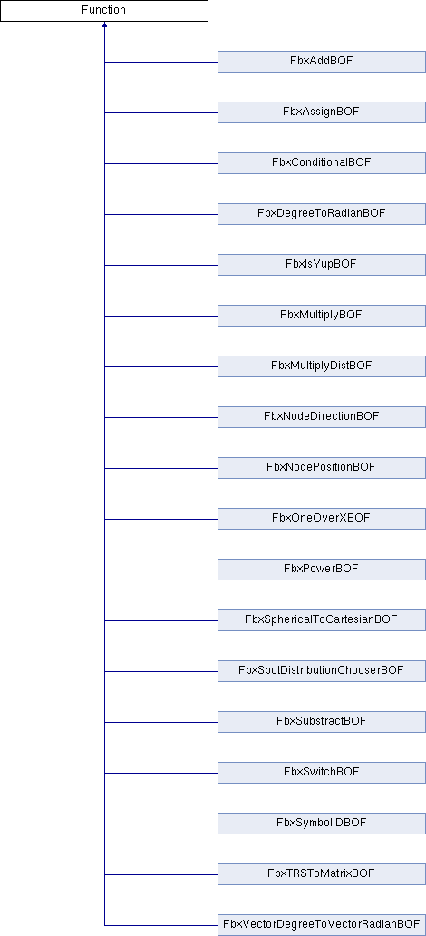

+ Inheritance diagram for FbxBindingOperator::Function:

Implemented in FbxSpotDistributionChooserBOF, FbxSymbolIDBOF, FbxIsYupBOF, FbxSphericalToCartesianBOF, FbxVectorDegreeToVectorRadianBOF, FbxDegreeToRadianBOF, FbxPowerBOF, FbxOneOverXBOF, FbxMultiplyDistBOF, FbxMultiplyBOF, FbxSubstractBOF, FbxAddBOF, FbxTRSToMatrixBOF, FbxSwitchBOF, FbxConditionalBOF, FbxAssignBOF, FbxNodeDirectionBOF, and FbxNodePositionBOF.
