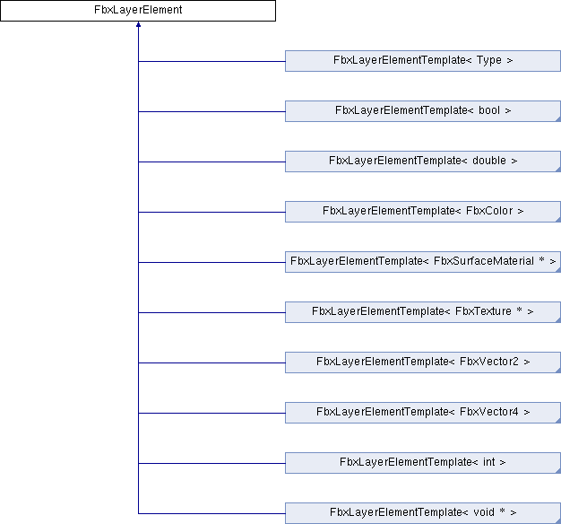

+ Inheritance diagram for FbxLayerElement:
