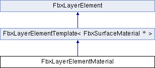

+ Inheritance diagram for FbxLayerElementMaterial:

Layer element for mapping materials (FbxSurfaceMaterial) to a geometry.
FBX SDK 2011 and later connects materials (FbxSurfaceMaterial) to nodes (FbxNode). The direct array of this class is no longer used. The integer "n" in the index array of this class represents the n-th material (zero-based) connected to the node.
For example:
Mapping mode eAllSame and index array {0} means the whole geometry is assigned with the 0-th material connected to the node.
Mapping mode eByPolygon and index array {0, 1} means the first polygon is assigned with the 0-th material and the second polygon is assigned with the 1-th material.
You can access the materials from a node by using FbxNode::GetMaterialCount() and FbxNode::GetMaterial(int pIndex) or the more generic calls to GetSrcObjectCount<FbxSurfaceMaterial>() and GetSrcObject<FbxSurfaceMaterial>(index)
For example:
FbxNode* node;
int nbMat = node->GetMaterialCount();
int index = layerElement->GetIndexArray()[0];
material = node->GetMaterial(index);
Remarks
The DirectArray() methods still exist for legacy reasons but has been made private and should not be used. Therefore, to be correctly saved in FBX file, this type of Layer element should have its reference mode set to eIndexToDirect.
