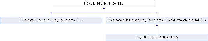

+ Inheritance diagram for FbxLayerElementArray:

FbxLayerElementArray is the base class for FbxLayerElementArrayTemplate, it provides lock handling and data array manipulation of the data buffer for FbxLayerElement.
