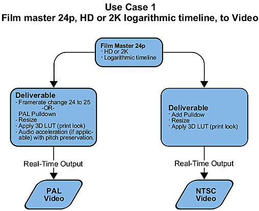

Film Master 24p, HD, or 2K Logarithmic Timeline, to Video
An important case addressed by Real-Time Deliverables is when an organization wants to take a 24p film master with an HD or 2K logarithmic timeline, and create real-time output to PAL and NTSC video format.
To output to PAL video, you would create a Deliverable that does the following:
To output to NTSC video, you would create a Deliverable that does the following:
From the Clip Output menu, the clip is output to tape with no need to render the preceding settings.
