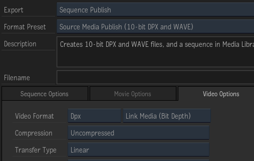

Link Media Export Options
Simple Link Media (Bit Depth) example:
- Import a sequence of 50 .dpx files, with a bit depth of 10-bit.
- Of that sequence, you colour correct only the first 10 frames.
- Export that sequence as a Sequence Publish, using the format preset
Source Media Publish (10-bit DPX and WAVE). Notice how in the menu Video Options, the box Link Original Media is set to Link Media (Bit Depth).
- The result of the export is 50 .dpx files:
- 10 new .dpx files created by
Flame
- 40 .dpx files referencing the original files
The last 40 files are referenced, and because they were neither created nor moved, the export process was that much faster.
