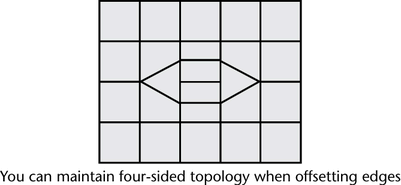

The Offset Edge Loop Tool lets you insert two lines of parallel edges on either side of the edge(s) you select. Offset Edge Loop is useful when you want to add localized detail to a polygonal mesh on either side of a single edge or line of edges.
When you edit a polygonal mesh, there is a risk that splitting the mesh surface from the usual ideal four-sided topology (quads) to triangles or some type of multisided polygon topology.
You can use the Offset Edge Loop Tool to maintain integrity of the four-sided polygon topology to insert edges either side of selected edges. When an edge is offset on a mesh comprised of four-sided polygons (quads), the Offset Edge Loop Tool creates two new edges either side of the selected edge and subdivides the faces, ensuring that the four-sided polygon topology is maintained.
