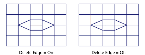

When offsetting edges on a partial interior edge loop the new polygons that get created at either end of the loop can be three-sided. When Delete edge is turned on the start and end edges of the loop are deleted to maintain a four-sided topology on the mesh. The Delete edge option is not available when the Tool Completion - Automatically option is turned on.

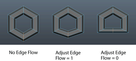

Lets you insert edge loops that respect the curvature of the surrounding mesh. This option is disabled by default, but you can toggle Insert with edge flow by selecting and deselecting Edge Flow from the marking menu (Ctrl + Shift + right-click).
Enter a value or adjust the slider to change the shape of the edges before they are inserted.

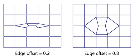

Edge offset is only available when Offset Edge Loop is set to work as an action. This option determines the distance the offset edges will be positioned on either adjacent side of the selected edge. The Edge offset units are based on a percentage of the distance between the selected edge and the adjacent edges on either side. For example, setting the Edge offset to 0.5 (default) positions the offset edges halfway between the selected edge and the original adjacent opposite edges.

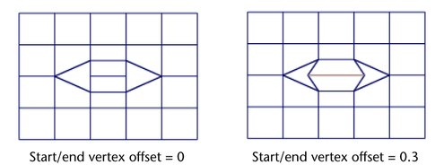

Determines the distance that the two vertices on either end of the selected edge (or a series of connected edges in an edge loop) will be offset inwards or outwards from their original position on the selected edge. The default Offset is 0. The Start/end vertex offset units are based on a percentage of the length of the selected edge.
Both Offset attributes can be edited using the Attribute Editor or the Channel Box by editing the PolyDuplicateEdge node.

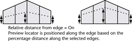

When the Maintain position is set to Relative distance from edge (default) the dotted preview locator is positioned along the selected edge based on a percentage distance along the selected edge. For example, if you click and then drag the selected edge to a location that is approximately halfway along the selected edge, the dotted preview locator appears approximately halfway between all of the other edges along the selected edge ring.

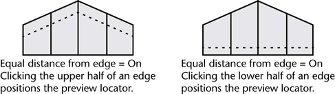

When Maintain position is set to Equal distance from edge, the dotted preview locator is positioned along the selected edges at an absolute distance based on where you click on the first edge. When the length of edges is highly variable, the tool uses the shortest edge to determine the maximum distance the preview locator can be moved. This option is useful if you want the new edges inserted at a specific distance from existing edges. For example, when you want to control any subsequent edge creasing you may perform on the mesh.
