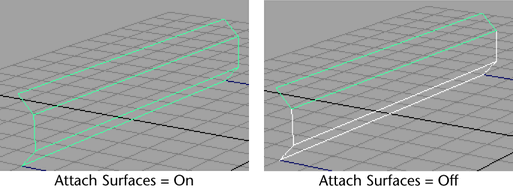

This option attaches each part of the bevel surface. If off, the surfaces are not attached. For example, if Attach Surfaces is off and you create a bevel with Bevel set to Both, three surfaces are created. These surfaces are independent and can be selected and modified as such.

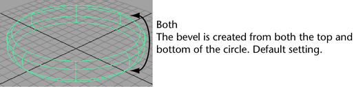

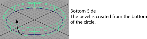

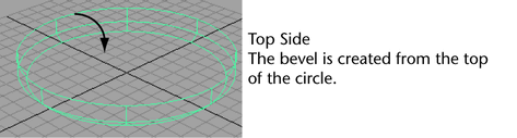

Specifies whether the beveled surface area is applied to the top, bottom, or both sides of the original curve or isoparm. The following example uses a NURBS circle primitive curve using each method.

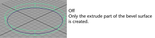

Setting the Bevel option to Off disables the bevel option controls (Bevel Width, Bevel Depth, Bevel Corners, and Bevel Cap Edge). If you do this, you can use Bevel for simple extrusions.

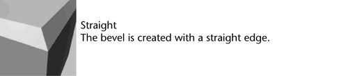

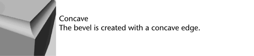

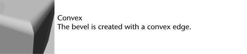

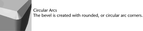

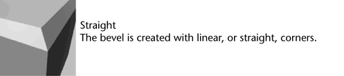

The Bevel Corners options specify how corners in the original construction curves are handled in the beveled surface. Note that if the curves are degree 1 or 2, the bevel’s surface is cubic (degree 3).
The Bevel Cap Edge options set the shape of the beveled part of the surface.
