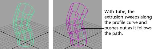

Tube sweeps the cross section along the path with the reference vector staying tangent to the path.

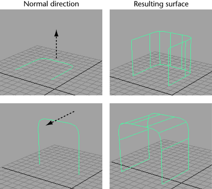

Profile Normal sets the direction of the path to the normal of the profile curve. If the profile curve is not planar, the average normal is used.

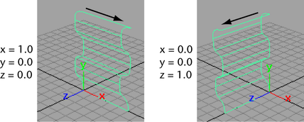

Specify lets you choose a Direction Vector for the extrusion: X Axis, Y Axis, Z Axis, or Free. For example, if you click the Z Axis button, the extrusion will be linear in the Z direction.
If you select Free, you can enter values in the X, Y, and Z boxes to specify a vector as the direction for the extrusion.

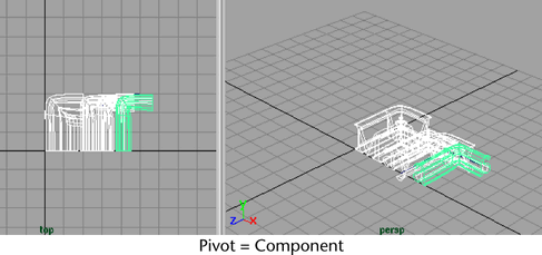

The Pivot options are available only if you set the Style to Tube. If you select At Path as the Result Position, you can choose the profile curve then position it at the pivot point on the extrusion path.

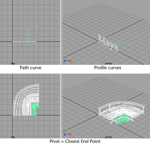

If you select Closest End Point, the path end point closest to the center of the bounding box of the profile curves is used. This end point is used as the pivot point for all the profile curves. If you are doing a multiple extrusion, the resulting surfaces are offset from the path.
If you select Component, the pivot point of each individual profile curve is used to extrude the profile curve. The extrusion occurs along the components of the profile curve.

If you choose Path Direction, the direction of the extrusion is set by the direction of the path curve. By default, the direction of the extrusion is set by the Profile Normal direction—the normal of the profile curve.

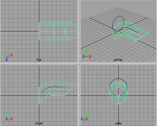

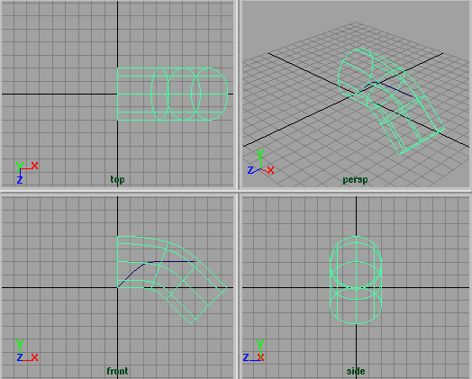

In the following example, Result Position is set to At Profile and Orientation is set to Profile Normal. The path curve is moved and rotated to match the profile curve. This is the default setting.
In this following example, Result Position is set to At Path and Orientation is set to Path Direction.

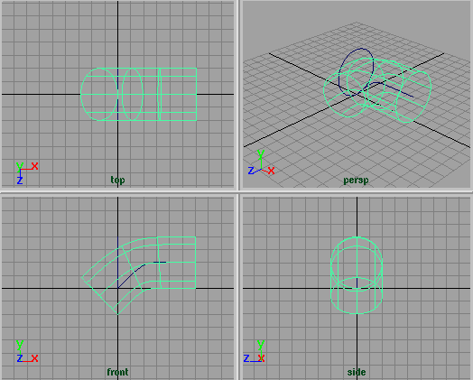

In the following example, Result Position is set to At Profile and Orientation is set to Profile Normal. The profile curve is moved and rotated to match the path curve.

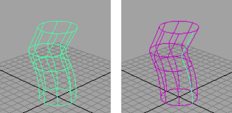

Rotates the profile curve as it is extruded along the path curve. Higher values cause the surface to stray from the path, especially with scaling.
Scales the profile curve as it is extruded along the path curve. Higher values cause the surface to stray from the path, especially with rotation.

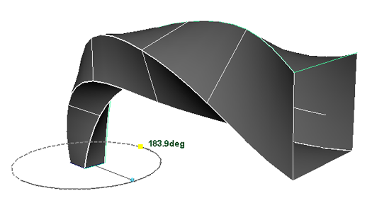

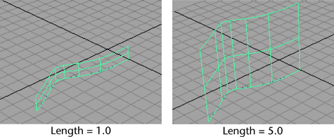

After you extrude the surface, select the surface, display the Channel Box, and select the Show Manipulator Tool. Click each of the subCurve nodes in the Channel Box to display the different manipulators available.
Experiment with the manipulators to see their effect on the surface. They let you change the length and sweep of the extrusion.
