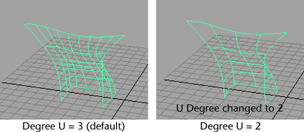

If Uniform is the rebuild type, the number of spans in the resulting surface can be set by the value you enter in the Number of Spans U/V boxes.
The degree of the resulting surface is determined by the Degree U or Degree V you select.
If you turn on Original, the U/V degree of the rebuilt surface is the same as the original surface.
Note that you can set Degree U or Degree V to Original and set Keep to NumSpans to create a uniform rebuild for several surfaces that have a different number of spans.
