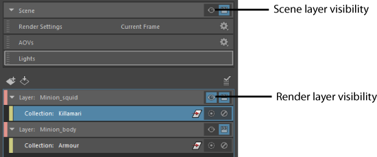

The scene layer controls the scene settings. It is similar to render layers in that you can control its visibility and whether or not it is renderable. Its Render Settings and Lights tabs also allow you to adjust the global Render Settings and global light settings. However, it is different from render layers in that it cannot contain collections or overrides.
The scene layer is referred to as masterLayer in the Render Settings window > Render Layer drop-down list.
Only one render layer can be visible at a time, whether it is a render layer you created, or the scene render layer. The layer whose objects are visible in the viewport is denoted with a highlighted
icon in the
Render Setup editor.
The scene render layer visibility is denoted by the
in the
Scene settings area, at the top of the
To switch to a different render layer, or to the scene layer, click
on the layer.
