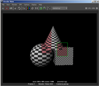

When you start an IPR session, Maya computes the initial IPR image, which is a deep raster format that contains more than just the final picture. Maya performs all the visibility calculations (only once), and stores the results in a file in the iprImages directory.

When you select a region to adjust, Maya loads all the necessary information into memory for all the pixels in the selected region.
As you modify scene attributes, Maya recomputes the shading calculations and the selected region in Render View updates.
Since none of the visibility calculations have to be recomputed at this stage, tuning updates much faster than a full software rendering.
