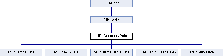

+ Inheritance diagram for MFnGeometryData:
