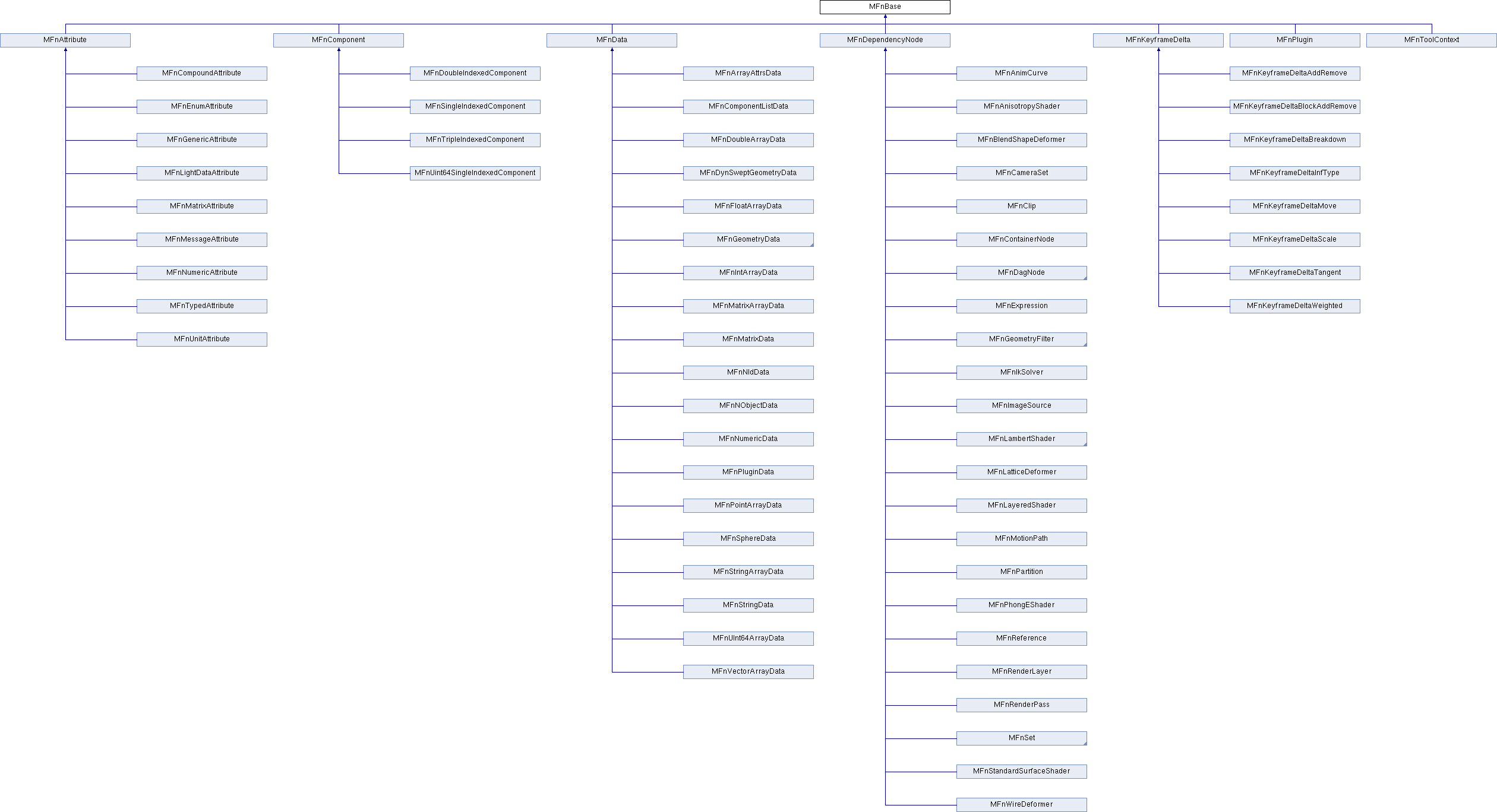

+ Inheritance diagram for MFnBase:

The link between an MObject and the role it performs as a Maya scene or model object, as well as the compatibility between MObjects and Function Sets is managed by the API Run-Time Type Identification (RTTI) system. The two key concepts of this system are the Maya Object type and the Function Set type (both are MFn::Type). All MObjects have one and only one Maya Object type. All Function Sets have one and only one Function Set type. MObjects may, however, be compatible with many types of Function Sets. This compatibility follows the class hierarchy of the Function Sets. Thus an MObject with Maya Object type MFn::kNurbsSurface would be compatible with MFnNurbsSurface, MFnDagNode, MFnDependencyNode, MFnNamedObject and MFnBase.
