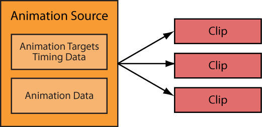

Animation Sources are the various types of data that you can use to drive the motion of an object. The Animation Source is the data that tells a model how to move. Without one, your object is static. Whenever you create an Animation Clip, even a single-frame Pose clip, the Time Editor creates an Animation Source. You can also create Animation Sources from existing animation in your scene (see Add Maya scene animation to the Time Editor). When you drag an Animation Source onto a track, a Clip is created.

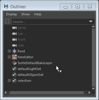

You can find the Animation Sources in your scene in the Time Editor Source menu as well as the Outliner. You can filter the Outliner so that you see only Time Editor nodes by entering timeEditor in the Outliner Search field.
Think of an Animation Source as a description of elements shown in the Roster, or as a container that stores the animation of objects in the scene. Animation Sources drive animation clips in the Time Editor. Any retiming workflow done to clips does not affect the original animation stored in the Animation Source.
Note: You can have only once Animation Source per Clip.
Animation Sources let you work in the Time Editor non-destructively; you cannot destroy the original data without first disabling the Time Editor and editing it in Maya. To learn how you can edit Animation Sources while working in the Time Editor, see Mute the Time Editor.
Tip: Animation Sources are independent; if you delete a clip or a track, the animation data is not deleted. You can test this if you delete a clip from the Time View in the Time Editor and then verify that the Animation Source information remains in the Outliner. Middle-mouse-drag the Animation Source from the Outliner back onto the Time Editor track to restore it. Working with clips in the Time Editor is non-destructive to your animation.
See Create clips from Animation Sources and Restore deleted Time Editor animation.
