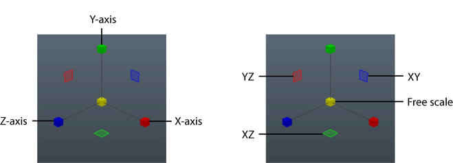

  3. Use the Scale manipulator in these ways to scale the selected objects:
