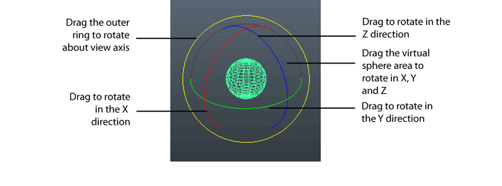

  3. Use the Rotate manipulator in these ways to rotate the selected objects:
