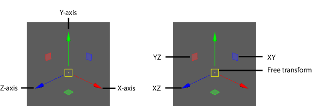

  3. Use the Move manipulator in these ways to change the position of the selected objects:
Tip: Hold down the W key and click on the object to show the marking menu for the Move Tool. The menu contains the same options that are available in the Tool Settings for the Move Tool.
