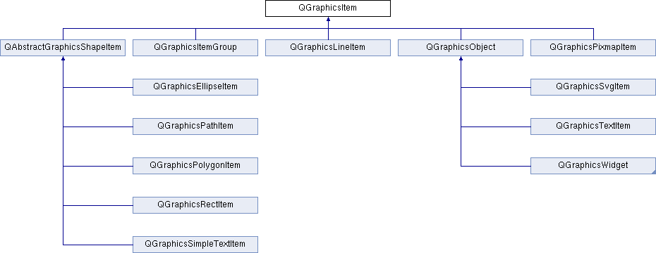

+ Inheritance diagram for QGraphicsItem:
