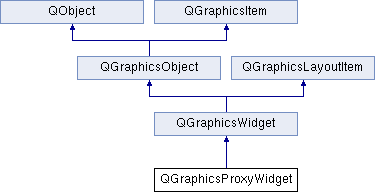

+ Inheritance diagram for QGraphicsProxyWidget:
