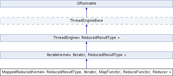

+ Inheritance diagram for MappedReducedKernel< ReducedResultType, Iterator, MapFunctor, ReduceFunctor, Reducer >:
