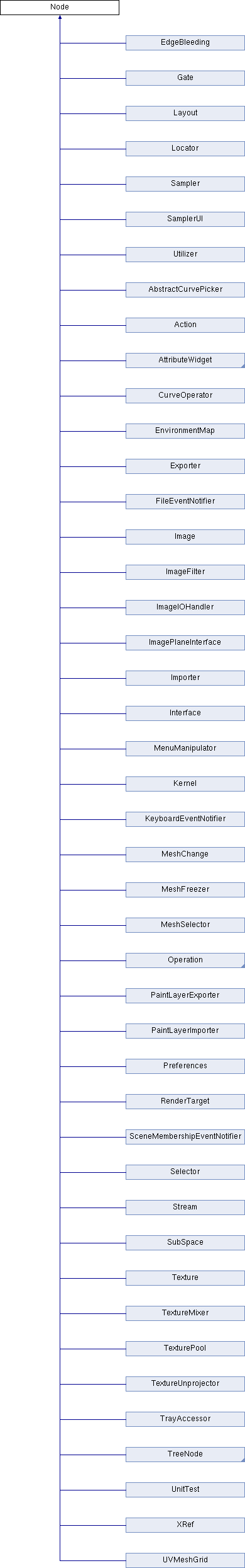

Class Description
+ Inheritance diagram for Node:
