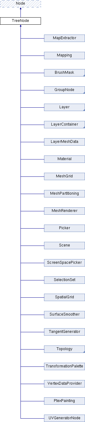

This class is the base of all node types that can be structured in a hierarchy.
+ Examples:
Definition at line 18 of file treenode.h.
+ Inheritance diagram for TreeNode:
