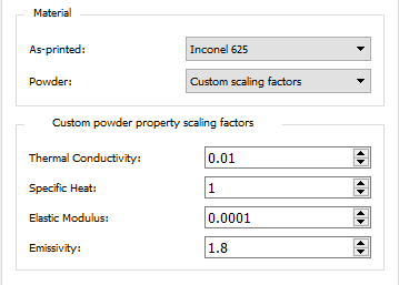

Custom scaling factors
By default, Powder properties, shown at the bottom of the New Process Parameters dialog, are approximated in PRM generation simulations using scaling factors. The powder property scaling factors are as follows:
To directly specify the powder properties, select Custom scaling factors in the Powder field, and adjust the values shown below.

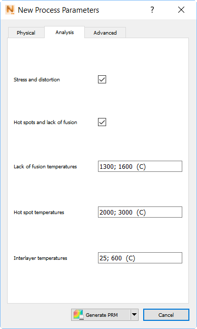

Analysis tab
On this tab, you can specify the type of analysis covered by the PRM file. Three possible types of PRM file can be created:
Stress and distortion is the default setting. If you select Hot spots and lack of fusion analysis, then the three temperature fields are activated for use.
For each of the following three temperature settings, you can enter multiple temperatures, separated by semi-colons, as shown above. You must provide at least one Lack of fusion temperature, or one Hot spot temperature, and one Interlayer temperature.
Lack of fusion temperature: Specify one or more temperatures below which the powder material will not fuse.
Hot spot temperatures: Specify one or more temperatures above which the powder is considered overheated. Different temperatures can represent the points at which particular undesirable phenomena occur.
Interlayer temperatures: Specify one or more temperatures that represent the material temperature at the start of laying down a new layer. Providing more values creates a PRM with higher resolution, but increased run time.
Best practices
To determine what interlayer temperatures are necessary, it is suggested that the part level geometry or geometries of interest for that combination of processing conditions are simulated using a standard stress and distortion PRM, and choosing the Thermal Only Analysis type in the Solver Settings menu. Determine from the simulation(s) the peak temperatures that can be experienced. This should be used for the upper interlayer temperatures, rounded up to the next 100° C. The lowest temperature should be set to the ambient temperature, typically 25º C. To determine what other temperatures should be used, plot the thermal properties of the material in question with respect to temperature. Add additional interlayer temperatures where observable non-linearities occur.

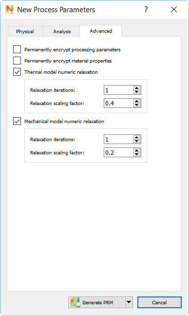

Advanced tab
This tab provides options to protect the intellectual property in your PRM, or to adjust the numeric relaxation used for by the solver during PRM generation.
Permanently encrypt processing parameters
By default, when a part-level simulation is run, the processing conditions used to generate the PRM file used are written to the log files. If the processing conditions are proprietary, users may want to encrypt them. Checking this box will encrypt the processing parameters in the PRM file and they will not be written to the log files. This choice is persistent, so once selected, all PRM files created will have encrypted processing parameters until this option is deselected.
Permanently encrypt material properties
By default, when a part-level simulation is run, the material properties used to generate the PRM file used are written to the log files. If the material properties are proprietary, users may want to encrypt them. Checking this box will encrypt the material properties in the PRM file and they will not be written to the log files. This choice is persistent, so once selected, all PRM files created will have encrypted material properties until this option is deselected.
Important: Encrypting processing parameters or material properties is irreversible. Ensure that the PRM file is given a descriptive name, as the processing conditions or material files are irretrievable after generation.
Thermal model numeric relaxation and Mechanical model numeric relaxation
These options are used to control the under-relaxation of the Newton-Raphson solver during PRM generation.
Relaxation Best Practices
