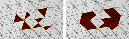

Left: Only one triangle is missing in each hole. They can be repaired with Close Trivial Holes. Right: All attempts to repair all holes regardless of complexity.

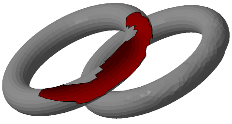

The hole in the torus to the left has been fixed on the right.
