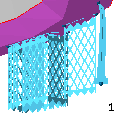

- Sets hold the values used when you create supports manually.
- A set can store the values of more than one support type at once.
- The generation parameters of already existing support entities can be changed instantly with the values stored in a set.
- Sets let you apply new values to currently selected, existing supports individually. Supports that were not selected keep their previous values even when the individual supports where all generated by the same support action.
- You can duplicate and modify sets, delete custom sets you do not need anymore.
- You can export sets, share, and import them.
- Machine workspaces can bring their own default sets.
- Netfabb comes with three default sets, each storing example variants for all support types, bar, volume, and polyline.
The three default sets come with variants for each support type.
