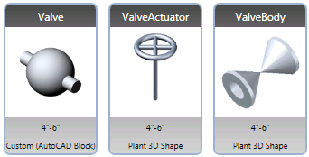

Catalog Builder - Group Tile View
Displays catalog template components with image previews.
Catalog templates define component classes (for example: Elbow, Pipe, Tee, and Valve) and a size range.
In the Component Type tree, select All or a component type to display a group view.
List view buttons are in the status bar.
Note: When you first load Catalog Builder after creating a new catalog template, you start in Group Tile View. To switch to Part Family view, select a component type (for example: Elbow) in the Component Type tree and click New in the Catalog Builder ribbon.
