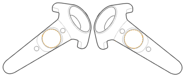

How to Switch Between Hands and Controllers
There are two ways to switch between displaying hands and controllers. With both, to return to the other state, repeat the action.
Note:
When using the controllers, tooltips appear to show which functions are controlled by which control.
For Left-handed Users
The controllers are mapped in such a way that both left- and right-handed users can use them.
The controller used to open the VR Menu automatically becomes the non-dominant hand controller. Therefore, if you are left-handed, you want to open the VR Menu with the controller in your right hand.

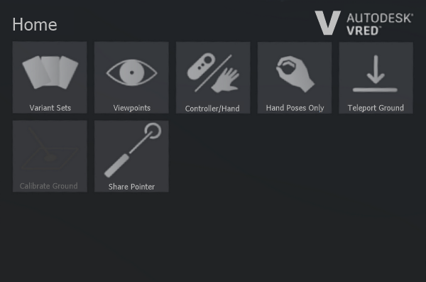

  1. Press VR Menu on your controller.
  2. In the VR Menu, do the following:
    • For other participants to see your pointer and draw their attention to something, enable Share Pointer.
    • When engaging with touch sensors and not wanting to draw attention, disable Share Pointer. This way, the pointer is only visible to you.

How to Calibrate the Ground Level
  1. In the VR Menu, enable Teleport Ground.
  2. Press Calibrate Ground. A green plane appears to represent the new ground plane.
  3. Move the green plane to where the ground place should be.
  4. Pull the trigger to select that spot and reset the ground plane.

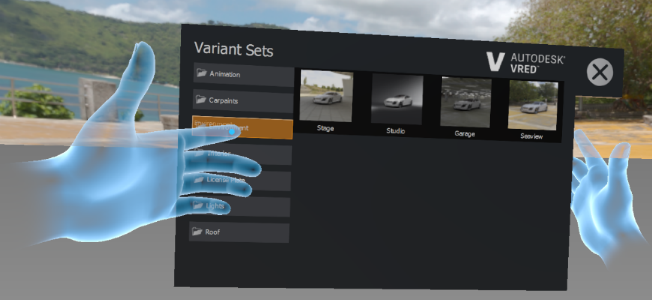

How to Access Variant Sets
If variant sets (VSets) are set up for a scene, they are accessible through the Variant Sets option in the VR Menu.
  1. Use the VR Menu on your controller to access the VR Menu home page.
    Panel Home
  2. Click Variant Sets to open the Variant Sets panel.
  3. Click a variant set to change something in the scene.
    Variants

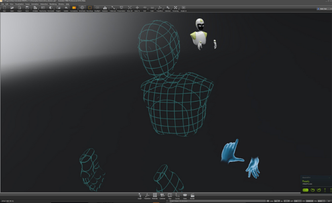

How the Safety Twin Works
When multiple participants are in the same real-world space, without some type of safety mechanism in place, collisions can occur. In VRED, we added the safety twin to provide a visual cue to keep you safe and help avoid collisions.
When a blue grid mesh appears (the safety twin), that indicated another participant is nearby.

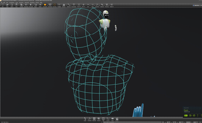

Safety at 100
As they move closer, the mesh of the safety twin begins to fade, becoming increasingly transparent.

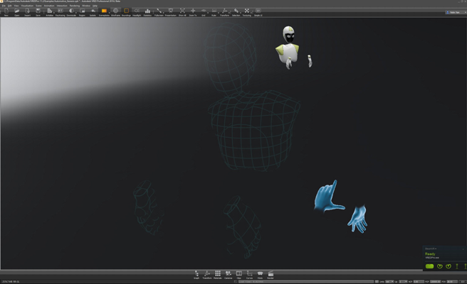

Safety at 50
If the safety twin becomes completely transparent, that participant is dangerously close.
