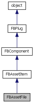

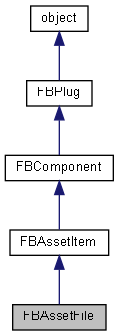

Class representing a file stored in a version control database. More...
Inheritance diagram for FBAssetFile:
