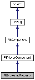

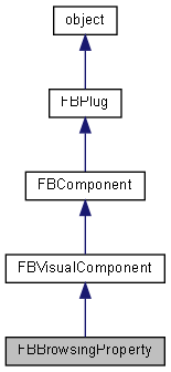

Inheritance diagram for FBBrowsingProperty:
