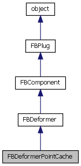

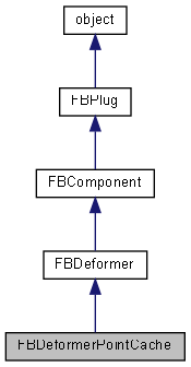

Inheritance diagram for FBDeformerPointCache:
