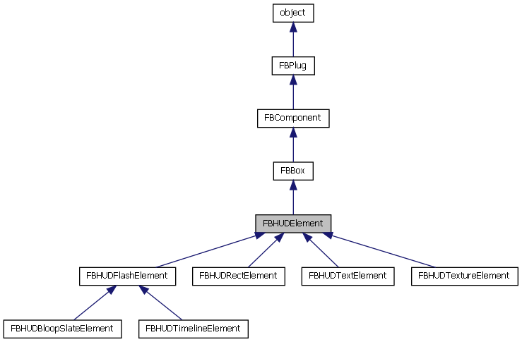

Heads Up display. More...

Heads Up display.
Display scene related information on a camera output. Rendered on video out, output renderings.
