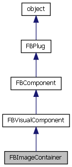

| | FBImageContainer () |
| | Constructor. More...
| | FBVisualComponent () |
