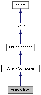

Scroll Box
This class provides a layout that will be automatically managed with a scrollbar according to the specified width and height.

Scroll Box
This provides a way to add dynamic UI control.
See sample: Scrollbox.py.
