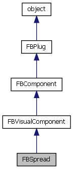

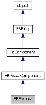

Base spreadsheet class. More...

Public Member Functions inherited from FBVisualComponent | |

Public Member Functions inherited from FBComponent | |
See samples: ActionScriptMgr.py, KeyboardMapper.py, Spread.py.
