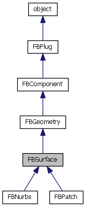

| | FBSurface (str pName) |
| | Constructor. More...
