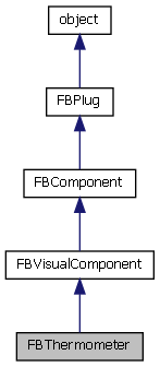

Thermometer. More...
Public Member Functions | |
| FBThermometer () | |
| Constructor. More... | |
| Clear () | |
| Reset bounds and value. More... | |

Thermometer.
| FBThermometer | ( | ) |
Constructor.
| Clear | ( | ) |
| float Max |
Read Write Property: Maximum value.
| float Min |
Read Write Property: Minimum value.
| float Value |
Read Write Property: Current value.
