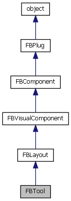

Tool class. More...

Tool class.
See samples: MBFileRefDemo.py, CloseTool.py, MoveResizeToolExample.py, SafeToolCreationExample.py, ToolCommunicationReceiver.py, ToolNativeWidgetHolder.py.
