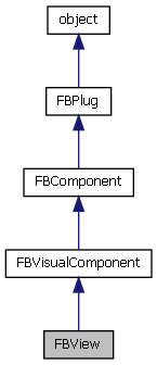

| | FBView () |
| | Constructor. More...
| | DrawString (str pText, float pX, float pY, int pEnable=-1) |
| | Draw a string in the view. More...
| bool | IsView () |
| | Checks if object is a view. More...
| | Refresh (bool pNow=False) |
| | Refresh view. More...
| bool | SetViewport (int pX, int pY, int pW, int pH) |
| | Set view's viewport. More...
| | FBVisualComponent () |
