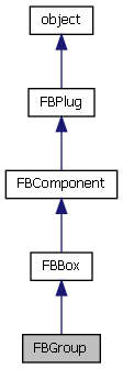

Objects Grouping class.
This class is an interface to manipulate object's grouping in the scene.
See samples: FBGetSelectedModels.py, FBGroup.py.
