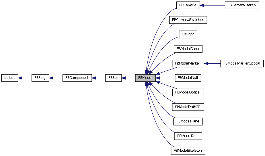

Model class. More...

Model class.
In the MotionBuilder UI, a model can be any object in a scene, created using geometry. Models can represent simple objects like cubes, or complex objects like characters.FBModel is a base class which is not used so much directly, but is the parent of well-used classes like FBCamera, FBLight, and FBModelMarker.It also implements a number of widely-implemented functions and attributes, such as: Clone(), FBDelete() UI attributes such as Show, Pickable, and Visibility Positional attributes such as Rotation, Scaling, and Translation The following Python snippet shows how to create, show, rotate, and delete a cube
There is a few ways to get a handle on existing models in a scene: FBFindObjectsByName return a list of objects matching a pattern (can contain *). For usage, see: FindObjectsWithWildcard.py If you know the name of the model, use FBFindModelByLabelName, as demonstrated in FBComponent.py. FBGetSelectedModels can get a handle to an object which is derived from FBModel. It searches the scene for a model, based on the model's unique name and returns a list of all the selected things in the scene.
See sample: ResetLocalTranslationRotation.py.
