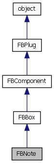

Note class. More...

Public Member Functions inherited from FBBox | |

Public Member Functions inherited from FBComponent | |

Note class.
