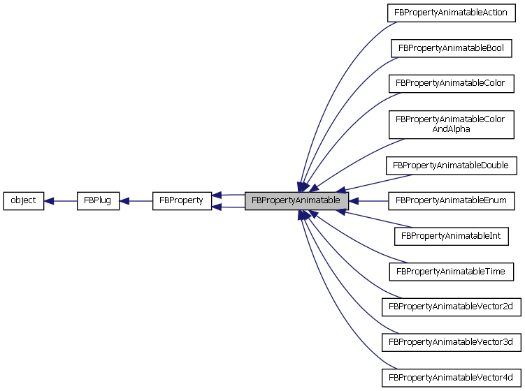

Inheritance diagram for FBPropertyAnimatable:

Detailed Description
Animatable property base class.
