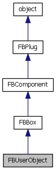

| | FBUserObject (str pName) |
| | Constructor. More...
| | FBBox (str pName) |
| bool | AnimationNodeDestroy (FBAnimationNode pAnimationNode) |
| | Destroy an animation node. More...
| FBAnimationNode | AnimationNodeInGet () |
| | Get the (IN/OUT) animation node for this box. More...
| bool | AnimationNodeIsUserData (FBAnimationNode pAnimationNode) |
| | Is the animation node user data? More...
| FBAnimationNode | AnimationNodeOutGet () |
| FBAnimationNode | GetInConnector (int pIndex) |
| | Get the animation node input associated with the given index. More...
| int | GetInConnectorCount () |
| | Get the number of animation node inputs for this box. More...
| FBAnimationNode | GetOutConnector (int pIndex) |
| | Get the animation node output associated with the given index. More...
| int | GetOutConnectorCount () |
| | Get the number of animation node outputs for this box. More...
| | FBComponent () |
| str | ClassName () |
| | Get the class name. More...
| | DisableObjectFlags (FBObjectFlag pFlags) |
| | Disable a specific Object Flags. More...
| | EnableObjectFlags (FBObjectFlag pFlags) |
| | Enable a specific Object Flags. More...
| bool | FBCreate () |
| | Open Reality Creation function. More...
| | FBDelete () |
| | Open Reality deletion function. More...
| | FBDestroy () |
| | Open Reality destruction function. More...
| FBObjectFlag | GetObjectFlags () |
| | Get all Object Flags (concatenated). More...
| bool | GetObjectStatus (FBObjectStatus pStatus) |
| | Check to see if an object status is enabled. More...
| FBFileReference | GetOwnerFileReference (p0) |
| | Get the owner FileReference object. More...
| | HardSelect () |
| | HardSelect. More...
| bool | HasObjectFlags (FBObjectFlag pFlags) |
| | Check whether a specific object flag is enabled. More...
| bool | Is (int pTypeId) |
| | Returns true if object is of type TypeId. More...
| bool | ProcessNamespaceHierarchy (FBNamespaceAction pNamespaceAction, str pNamespaceName, str pReplaceTo=None, bool pAddRight=True) |
| | ProcessNamespaceHierarchy. More...
| bool | ProcessObjectNamespace (FBNamespaceAction pNamespaceAction, str pNamespaceName, str pReplaceTo=None, bool pAddRight=True) |
| | ProcessObjectNamespace. More...
| int | PropertyAdd (FBProperty pProperty) |
| | Add a property to the component's property manager. More...
| bool | PropertyAddReferenceProperty (FBProperty pReferenceProperty) |
| | Add a reference property to the component's property manager. More...
| FBProperty | PropertyCreate (str pName, FBType pType, str pDataType, bool pAnimatable, bool pIsUser=False, FBProperty pReferenceSource=None) |
| | Create user or dynamic property. More...
| | PropertyGetModifiedList (FBArrayTemplate< FB > pPropList, FBPlugModificationFlag pModificationFlags) |
| | Get list of properties which have been modified since last loading. More...
| | PropertyRemove (FBProperty pProperty) |
| | Remove a Property from the component's Property manager. More...
| | SetObjectFlags (FBObjectFlag pFlags) |
| | SetObjectFlags. More...
| | SetObjectStatus (FBObjectStatus pStatus, bool pValue) |
| | Enable/Disable a specific Object Status. More...
