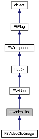

Public Member Functions inherited from FBVideo | |
| FBVideo (str pName) | |
| Constructor. More... | |
Public Member Functions inherited from FBBox | |
| FBBox (str pName) | |

Public Member Functions inherited from FBComponent | |
| FBComponent () | |
