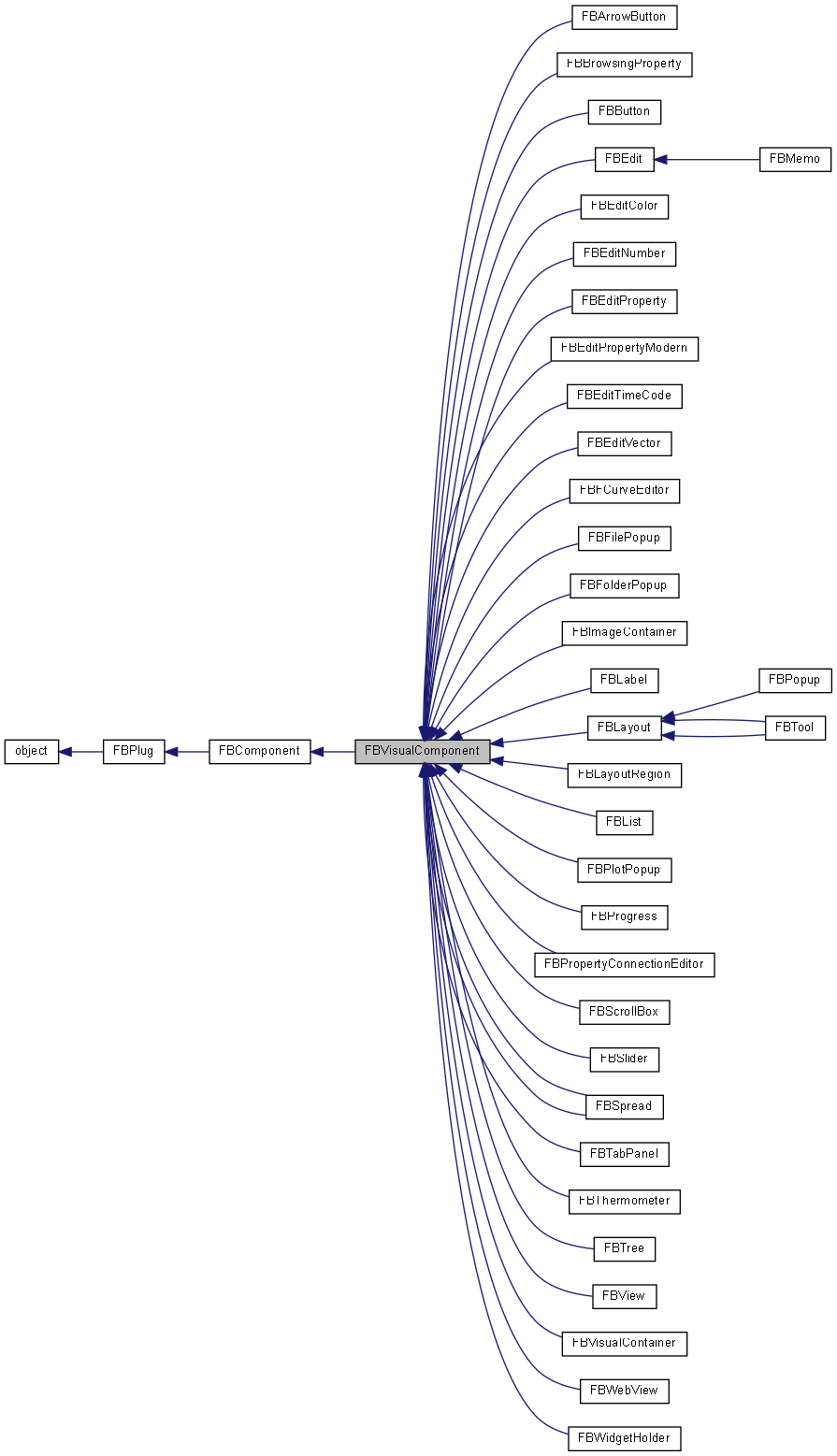

Inheritance diagram for FBVisualComponent:

Detailed Description
Visual Component base class.
All of the user interface elements available in the SDK derive from this class.
