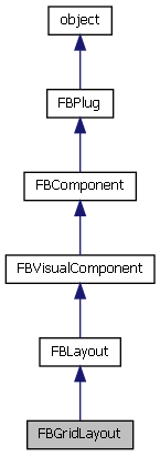

More advance layout that allow organisation of control in a grid.
User can place a control at specific coordinates. User can also setup parameters that affect whole row or column.
