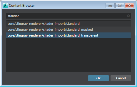

For example, to change a material that uses the "standard" material as its parent to instead use the "standard transparent" material:
In the Property Editor, click the Select resource icon
next to Parent Material.
The Content Browser displays, which lists all possible materials in your project, including all child materials.
In the Content Browser, start typing in the Search field to narrow the listings, and select the new parent material.
