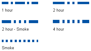

| General/Linetype | Specifies the linetype of the fire rating line. In the fire rating line tools shipped with AutoCAD Architecture 2021 toolset there is a specific linetype for each fire rating level - for example, the 1 Hr fire rating line tool has the Aec_Rating_1Hr linetype specified. The linetypes for rating line tools have been added to the acad.lin and acadISO.lin files. |
